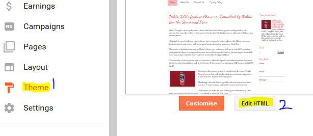

Step 4: Log in to your blogger dashboard, ==> From the left menu items ==> click on Theme and then Edit HTML.

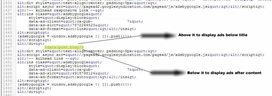

Step 5: Click inside the blogger template codes and ==> press CTRL+F to activate search. Search for <data:post.body/> and place the ads (copied from step 3) just above it to display ads below post title and below it to display ads after post, before comments/social share buttons.
place Google adsense in various positions on blogger
Note: Most templates do come with more than one <data:post.body/>. So you can experiment with the first or second <data:post.body/>, depending on which works for your theme. But first or second <data:post.body/> will normally work for 90% of blogger templates.

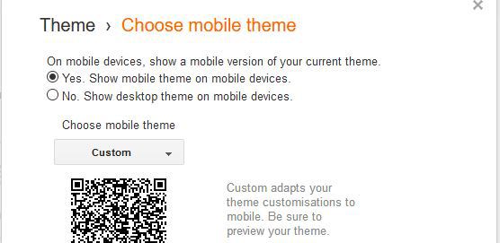

Step 1: Enable mobile theme by ==> logging in to your blogger dashboard, ==> navigating to theme and click the mobile theme option(s) to activate it. Select the custom theme option as seen in the screenshot below.

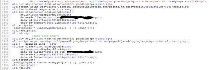

Step 3: Ensure that the mouse cursor is blinking inside the blogger codes by clicking on it. And then, ==> press CTRL+F to activate search. Search for –
<b:includable id='mobile-post' var='post'>
Note where this code is first seen and use the arrow button to gently scroll down until you see the code below: –
<div class='post-body entry-content' expr:id='&quot;post-body-&quot; + data:post.id' itemprop='articleBody'>
Step 4: Paste your Google adsense code directly below it as seen in the screenshot below.
blogger adsense placement tutorials
That’s all. Your ads should start displaying in these positions as soon as you save the template.   You can also play around with other positions like; before copyright, after comments and so on.
