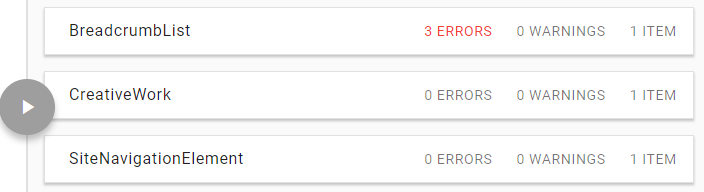

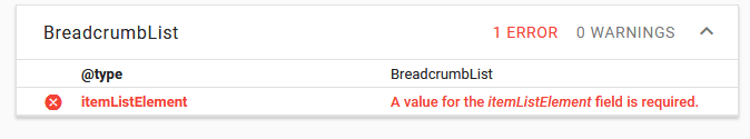

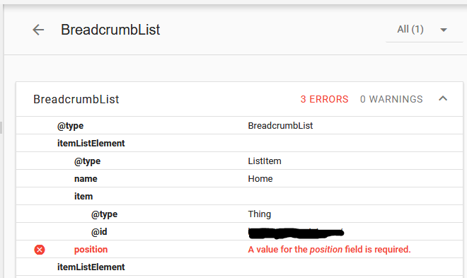

If you’ve just tested your blog(s) that have breadcrumbs enabled and seeing any of these BreadcrumbList Errors:
  • itemListElement position error:  A value for the position field is required.
  • @type BreadcrumbList (itemListElement): A value for the itemListElement field is required.

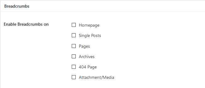

And similar errors related to breadcrumb list. The quickest fix for this would be to turn off genesis breadcrumbs from ==> Genesis ==>  Theme Settings ==> and then apply the little tweak below.
fix structured data errors on genesis framework
uncheck all boxes to turn off genesis breadcrumbs

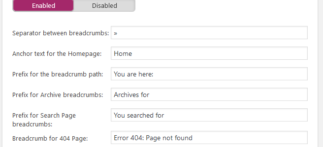

Step 3: From the search appearance windows, navigate to Breadcrumbs ==> switch it to enabled, and set it up with the correct values.
enable yoast SEO breadcrumbs

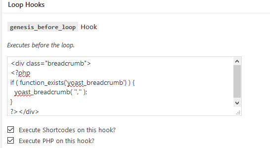

Step 5: Search/find genesis_before_loop Hook and paste the code below inside the box.
The code to paste here is either this:
<div class="breadcrumb">
<?php
if ( function_exists('yoast_breadcrumb') ) {
  yoast_breadcrumb( '','' );
?></div>

Step 6: Tick the boxes to Execute Shortcodes and PHP on this hook?
tick the check boxes
